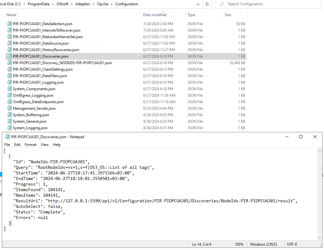

    Hello Jiyeon,
    Do you mean change something int the file ���PIR-PIOPCUA301_Discoveries.json��� ?
    To add discoveries I am using this:
    edgecmd add discoveries -cid PIR-PIOPCUA301 -id NodeIds-PIR-PIOPCUA301 -query "RootNodeIds=ns=1;s=f|OS3_OS::List of all tags"
    To generate the file ���NodeIds-PIR-PIOPCUA301.csv��� I am using this:
    edgecmd get discoveries -cid PIR-PIOPCUA301 -id NodeIds-PIR-PIOPCUA301 -result -file C:\Adapter\NodeIds-PIR-PIOPCUA301.csv -csv
    [cid:image003.png@01DADE76.64120260]
    Is it possible to remove columns ���selected,name,streamId,dataFilterId��� ?
    Is it possible to add other attribute column to this file?
    For example ���StatusCode���:
    [cid:image004.png@01DADE78.5150E9F0]
    [cid:image002.png@01DADE75.381E7130]

    With the Discovery option, it will capture the information that is readily available in the OPC UA server. The "name" and "dataFilterId" properties are ones that you can specify (optional). If you would prefer to manually change this information before you push it into Data Selection configuration, you can add the following line to your Discovery request:
    "autoSelect" : false
    For example:
    "id" : "SampleId",
    "query" : "RootNodeIds=ns=1;s=MyDevice",
    Assuming you've installed the adapter on a Windows device, the exported configuration file can be found in your %programdata%/OSIsoft/Adapters/OpcUa/Configurations folder. You can open the json file and modify those parameters as you see fit. You can also use EdgeCmd Utility to export it as a .csv file to more easily update it using applications such as Excel. Once you've made the appropriate modifications, you can use EdgeCmd again to pull in the .csv file (or json file if you choose to stick to that format) into your Data Selection configuration. It looks like we do not provide an example of this in our documentation - I will work with our tech writers to update it with more details.
